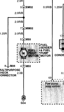

9 years 5 months ago #9422 by Tyler
Replied by Tyler on topic P0335 DTC Causing No Start
Diagram! This part of it is actually readable.
The pump wires are red/black (power) and black (ground), pins 4 and 5. With the engine cranking, you should see around 10V at at the red/black wire, and pretty much 0V on the black. If you have both and there's still no fuel, then stick a fork in the pump, 'cause it's done.
If you DON'T have power at the red/black, then you can attempt to power the pump manually with the PowerProbe. Just be double sure you're on the correct wire, and that the fuel line up at the engine is pointed into some kind of container. ;-) If you now have fuel, then you can reconnect that line and see if you can make the engine run with the Probe powering the pump manually.
