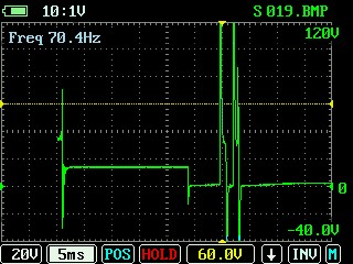

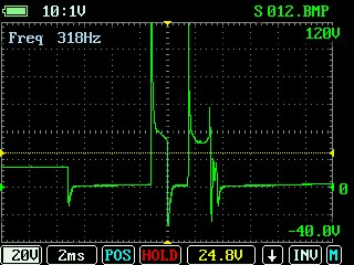

Good afternoon all. New Premium member, also new to the lab scope. I took some readings on a 93 Wrangler 2.5L M/T (amp clamp on primary negative) 2 wire coil and am trying to identify what I am seeing here. Looks like nothing I have seen while doing my research. Any input would be greatly appreciated. If I did this correct there should be 3 screen shots attached here. Looking at these wave forms I am leaning twords the ignition driver in the SBEC is not switching correctly. The vehicle has a hard constant miss, feels like it is only firing on 2 cylinders. Good Cam and crank signal happy to post those if needed.

Ah, gotchya. What do you make out of that crazy wave form I posted? There is somethin definitely wrong. It looks like the ignition coil driver is not firing correctly. I am trying to get a second opinion before I condemn a computer. It looks like the coil is charging up and saturating but failing to be pulled down consistently, or am I reading it wrong?

To see if it is "pulling down", consistently, capture a Primary Voltage waveform. Swap out your amp probe for test leads. Negative lead to BAT (-). Positive lead to the Coil control wire.
When the coil is not energized, you should see battery voltage on the control wire. When the PCM energizes the coil, the voltage on the control wire will be pulled down to zero. When the PCM De-energizes the coil, there will be a voltage spike on the control wire that could reach 400 volts.  This is where you need 10:1 attenuation because the maximum voltage input of the uScope is 40 volts. An attenuator is used to reduce the 400 volts down to 40 volts before it enters the scope. To account for this, the 10:1 setting on the scope will multiply the input voltage by 10 and display the proper, original, voltage output on the screen.
Are your Coil Current waveforms captured with the engine running, engine cranking, or energizing the coil manually? Because I agree with Tyler. 30+ ms dwell time is crazy.

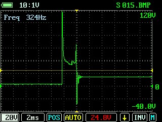

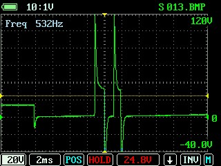

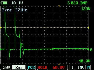

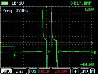

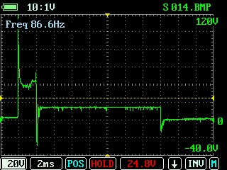

Here are the screen shots from the new test. Primary coil control back probed. Engine at idle. The shots showing 2 wave forms back to back, is that something I am doing wrong with the scope? none the less these don't look good
Base on those Primary Voltage waveforms, I would pull the spark plugs to make sure they are not fouled.
But, the thing that concerns me the most is the back-to-back firing events. It will be impossible to do with a single channel scope, but I would like to see a waveform of Cam, Crank, Coil control, and #1 injector control, all at once.

I unfortunately do not have access to a 4 channel scope. What caught my eye is on some of these snap shots the voltage is not coming back up to 14V after coil discharge like the very last screen shot (S015.bmp) which looks like it should.
Good eye! If you had a 2-channel scope, I bet the current waveform would show these areas as some crazy-long dwell times. I think that I would disconnect the coil control wire from the Coil and PCM. A continuity to ground check with an Ohm meter should display OL. Give the wiring harness a good wiggle and watch the Ohm meter for any continuity to ground. If no faults are found with the control wire, I would begin to suspect a faulty PCM. However, I would still want to see Cam/Crank and coil and injector controls, all together.
