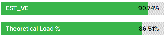

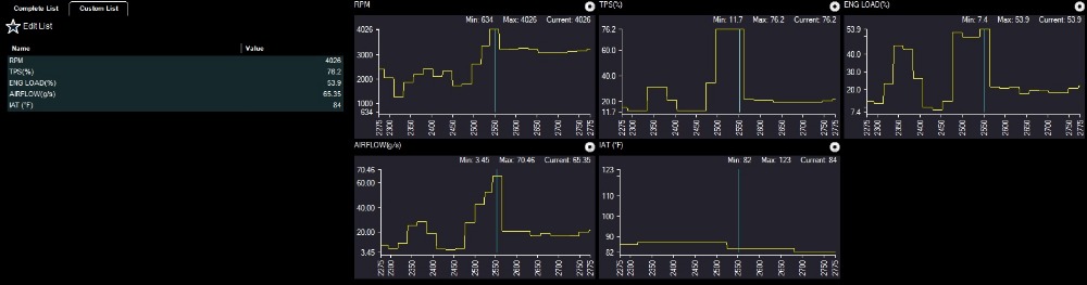

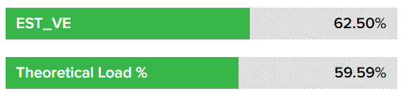

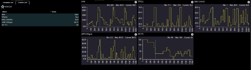

Not trying to be argumentative, but would you mind checking my understanding? I had a Lexus that I believe was a good example of a measurement error causing a low VE calculation.
'99 ES 300, 3.0L, dirty MAF numbers:
And after cleaning:
In this situation, both Load and VE showed low values. With the VE test alone, I'm not sure how a distinction could be made between a measurement or breathing problem. Not unless the upstream sensors are considered. Or, was that your point? :silly:

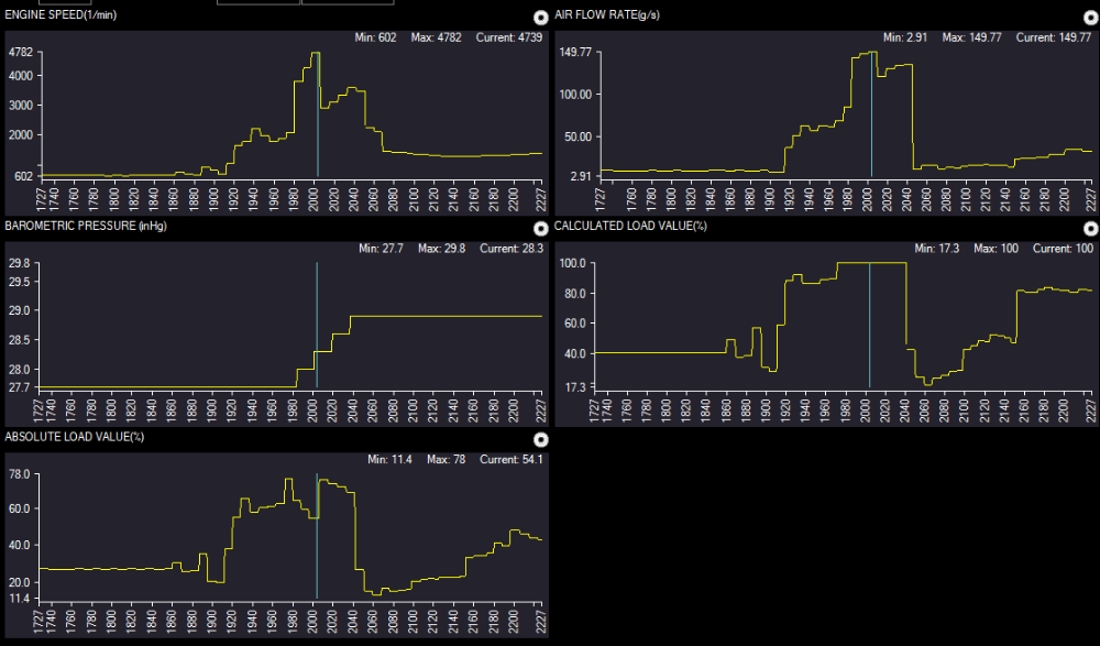

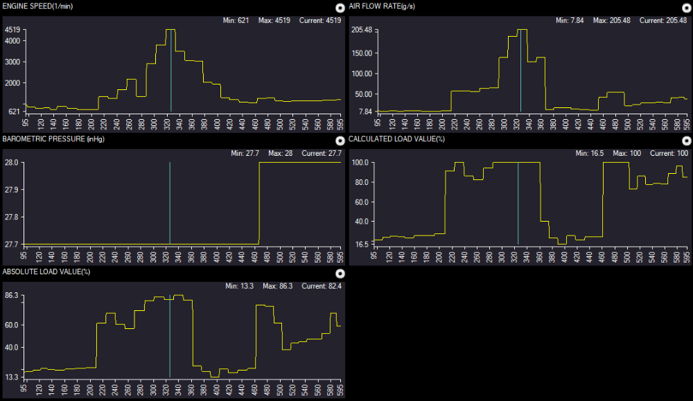

For any SD Premium subscribers following that may (not) be following along, the Lexus RX330 Low Power series has been bugging me for this exact reason.
www.scannerdanner.com/scannerdanner-prem...le-codes-part-1.html
It was gutless with skipped timing, but the Load went to 100% during a WOT snap in park. :blink: As far as I'm concerned, that's a useless Load calculation.
For example, excessive engine ping. I find it is most often caused by the MAF under-reporting air flow (timing advanced)
Right on the money here. The same Lexus I got those VE numbers from also had knock sensor codes for both banks. No knock and no codes after cleaning, but the service advisor gave me the most sideways look when I didn't want to sell knock sensors. :lol: :silly:

Posting up a truck that threw me for a loop recently. Seems like the Load PIDs kinda let me down... :(
'07 Ford F-150 has a noticeable lack of power from a stop, and at WOT. I took a drive with Global data, and saw these (reduced the PIDs down to the relevant parts):
Calculated Load says everything's good. 100%. But Absolute clearly isn't happy at 54%. I consult the ATG VE Calculator to break the tie:
Tough to argue with that. Calculated Load lied to me. :angry:
After the repair, I recheck the numbers:
Much better. B) Absolute Load = 1, Calculated Load = 0.

Hi Tyler
I noticed you've used global data. That's good, it means the load pids have very specific definitions.
Calculated load will be 100% at WOT, so if one is looking to use this to evaluate breathing or the MAF, it won't work. It is't meant to be used that way.
Absolute load tells you most of what you need to know. "Most", because it depends on what you're trying to determine.

Here is a capture of calculated load using a generic scan tool, but it is a 2006 Envoy. It doesn't follow the later rules. It does peak at 99%, but it is way high with far less throttle.
This was made with an AE scan tool interface and their phone app (Gioto).
www.scanshare.io/share/k7NNFC7RGEGLcnOte6_byg#0,1,4,5
