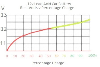

Estimating State of Charge
For the tech working with modern sealed batteries the rest voltage is the only viable way of estimating what the batteries “state of charge” . For the tech or mechanic checking the battery voltage before you do any diagnosis or repair on a vehicle is always smart move, A battery showing a no load voltage of 10.5v or less is completely discharged, below 10.5v especially with modern batteries the battery will suffer damage, possibly to extent it cannot be recharged. If in doubt before working on the vehicle connect a charger and charge the battery at a low amps setting.
Rest Voltage v Surface Charge.
When a battery has been recent charged either from the alternator or a battery charger it will show a voltage higher than the rest voltage for anything from minutes to several hours afterwards, this is caused by a charge on the plate surface that hasn’t yet penetrate into the bulk of the plate material. As a rule of thumb if you watch battery voltage the on a car with a good battery and charging system the voltage will drop from about 13.8 -14.9v engine running, to about 12.9-13.1v immediately the after engine stops then more slowly to 12.4-12.7v after the engine has be stopped for a few minutes.
How to Quickly Remove the Surface Charge
If the battery is to be tested immediately to get a true picture of the health and state of charge of the battery the surface charge can be removed by switching on the headlights for about 3 minutes before testing. If the battery voltage drops fairly quickly after switching on the head lights this is a good indication of a problem with the battery usually a shorted cell also sometimes called a “gassing” or “boiling” or “dead” cell.
Fully Charged Rest Voltage v % Estimated State of Charge
NB Voltage will vary with temperature --- low temperatures = lower voltage, higher temperatures = higher voltage.
This chart shows the charge % v Rest Voltage relationship at around 30c or 70f If the battery is really cold, ie somewhere around 0c/32f add 0.1v to the measured voltage.

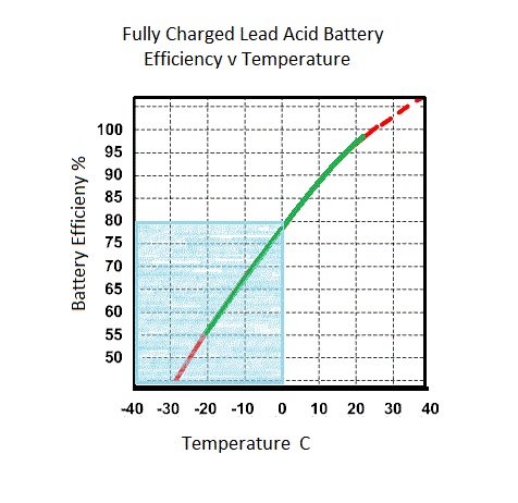

Cold Weather
How well a battery cranks an engine depends greatly on temperature, at freezing point (0c or 32f) a new fully charged battery will only have 80% of its’ performance at room temperature. In really cold winter conditions -20c or -4f the performance drops to 55%. If the battery has only a partial charged in semi-arctic conditions the battery electrolyte can also freeze. Don’t attempt to charge or jump start a frozen battery without first thawing it out.
In an effort to improve cranking performance in cold start conditions from around 1990 battery manufacturers introduced calcium doping to the lead plates, to replace the antimony additives previous used.

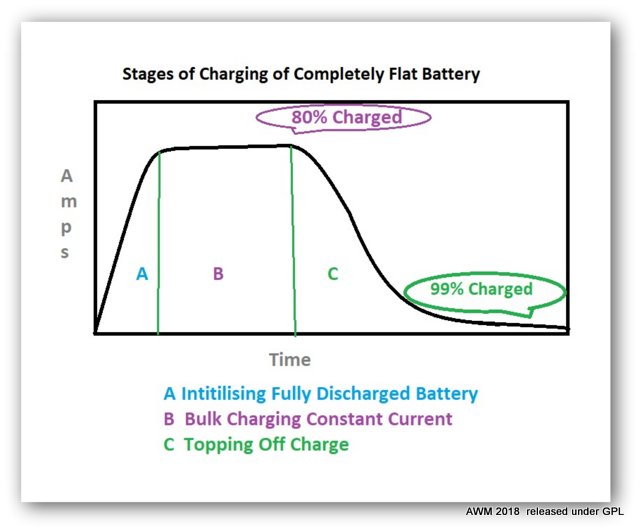

Initial Charging & Recharging Completely Discharged Batteries.
A 12v lead acid battery is not a resistor it is not a capacitor it is a chemical reaction in a box, this becomes apparent when attempting to recover a completely discharged battery which is a slow and sometimes difficult process or in the case of calcium type often impossible. Additionally most modern fully automatic “smart” chargers will refuse to charge a completely discharged battery (see section on smart chargers) unless tricked into doing so.
When a battery is new or completely discharged the cathode(-) and anode (+) plates are not in a condition to accept charge. The charging current will sit at or near zero until after some time has passed the battery starts to accept charge and the charging current ramps up. Normally the vast majority of batteries you will encounter will have some charge remaining and will go directly into the next stage the constant current or bulk charging stage.
Constant Current or Bulk Charging Stage
In the bulk constant current stage the battery accepts a fairly constant current until it reaches around 80% charge at which point it will naturally taper off as it approaches a fully charged state. Depending on how much charge the battery had at the start of re-charging this stage can take up to 3 to 4 hours to fully complete. At the end of this constant current stage depending on the battery charger type and setting and also the battery type the voltage measured across the battery terminnals will have risen to somewhere between 14.2 and 14.9 volts
Topping off or Constant Voltage Phase
The next stage to top off the remaining 20% of charge takes longer. Only when the charge current drops below 2 to 3% of the ah rating (for our example on 70ah battery 1.5 to 2 amps) the battery can be regarded as charged. To fully complete this stage can take an additional 4 to 5 hours.
Taking our 70ah car battery as an example the constant current phase should ideally be about ah/20 (3 to 4 amps) but ah/10 (6 to 8 amps) will not cause excessive damage and ah/5 (up 18 to 20 amps) for a few minutes. Using the very high current starter booster setting on powerful shop chargers is a last resort measure it is very bad for the battery and causes over voltage in the cars electrical system.
Charging VoltageThe ideal battery peak charging voltage for most tradditional automotive car and truck lead acid batteries in temperate climate is 14.2 to 14.6 volts.
In freezing conditions this can be increased to 14.8 volts many modern automatic “Smart” chargers have * Winter setting for charging in sub or zero conditions. With old style “dumb” chargers you can simply select a suitable higher setting.

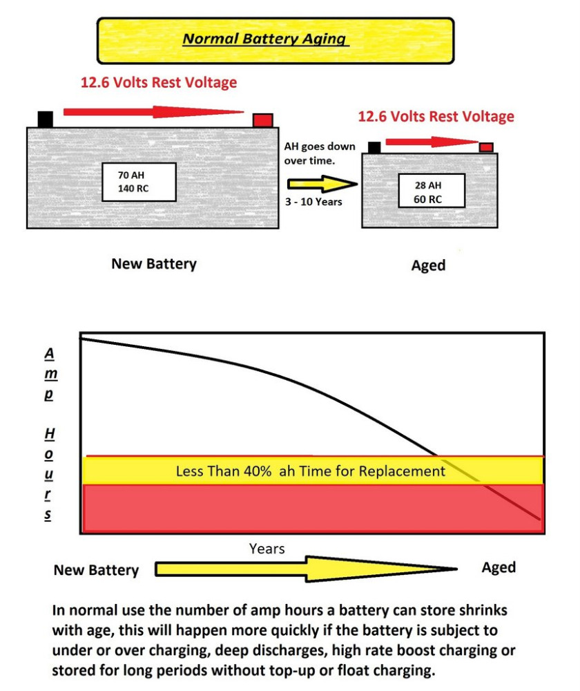

  • Andy.MacFadyen
8 years 3 months ago - 8 years 3 months ago #21777 by Andy.MacFadyen
Replied by Andy.MacFadyen on topic Car Battery basics Part1
Battery Life Cycle Under Normal Use - Battery Aging
Over years of use even if not subject to neglect or abuse the number of amp hours a battery can store becomes smaller although the open circuit rest voltage may remain unchanged. In normal automotive batteries a drop to 40% of the original amp hour capacity is considered the cut off point for replacement. In effect our example 70 ah battery shrinks to 28 ah. Even at only 20 to 30% capacity the battery may still continue to start the car in normal use but it will have no reserve capacity if for example the lights are left on for even a short period. When maintaining emergency service vehicles and other critical applications a higher percentage of original capacity should be chosen as the cut-off point.
Last edit: 8 years 3 months ago by Andy.MacFadyen.

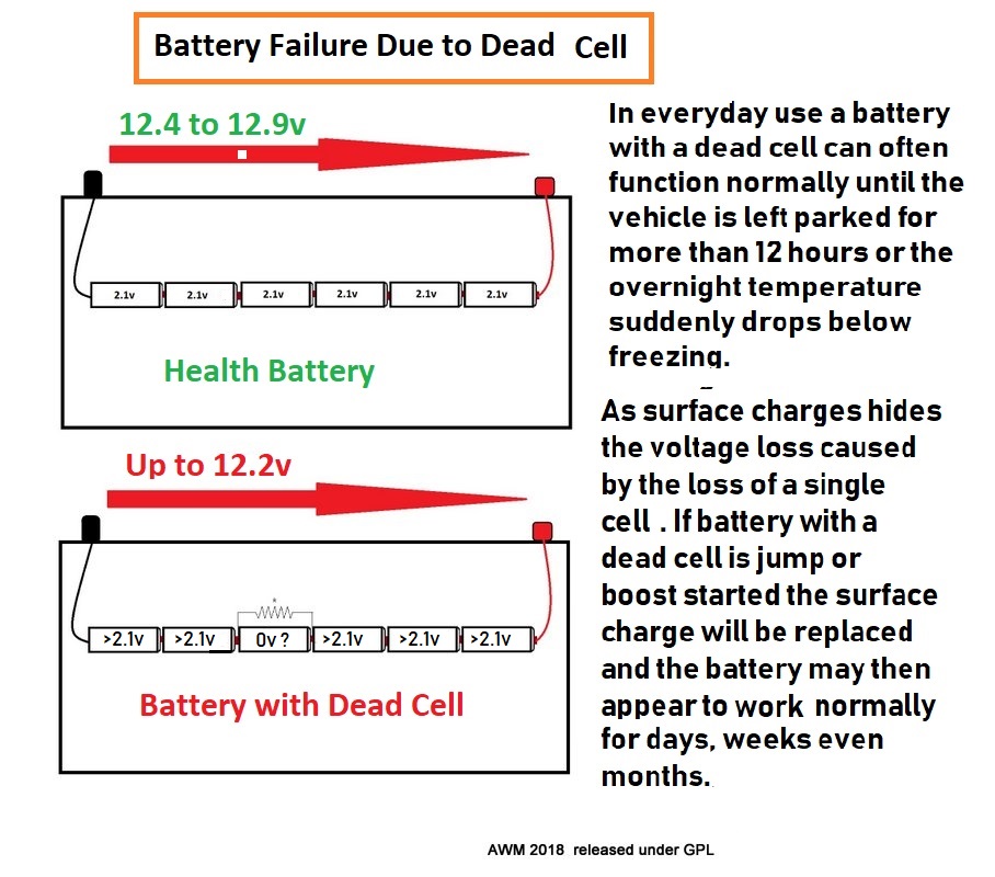

  • Andy.MacFadyen
8 years 3 months ago - 8 years 3 months ago #21788 by Andy.MacFadyen
Dead Cell Failure
A Dead cell also known as a shorted or gassing cell is when the sulfation or buckling of the battery plates causes a 6 cell battery to function as a 5 cell battery. This used to be the most common type of battery failure causing a no crank no start. With only 5 working cells the remaining cells recieve a higher charging voltage and have a higher than normal surface charge which will mask the effects of the dead cell until heavy demands are placed on the battery by cold weather or the vehicle parked for more than a few hours.

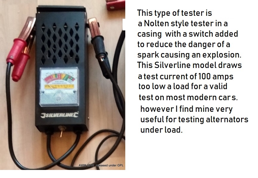

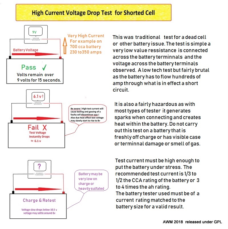

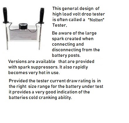

  • Andy.MacFadyen
8 years 3 months ago - 8 years 3 months ago #21794 by Andy.MacFadyen
4 High Current Draw Voltage Drop Battery Testers
These tools are from the reputable UK brands Durite and Sealey

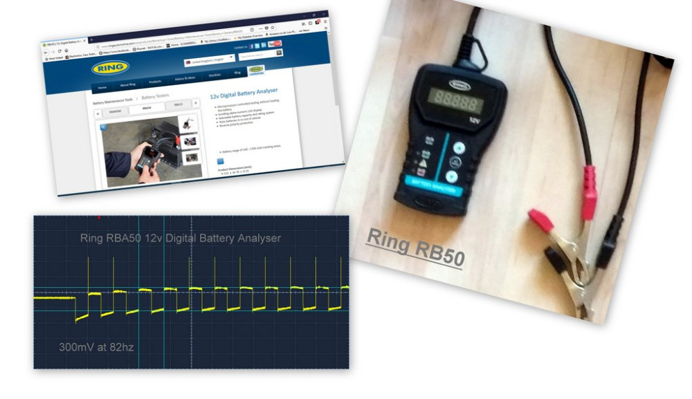

  • Andy.MacFadyen

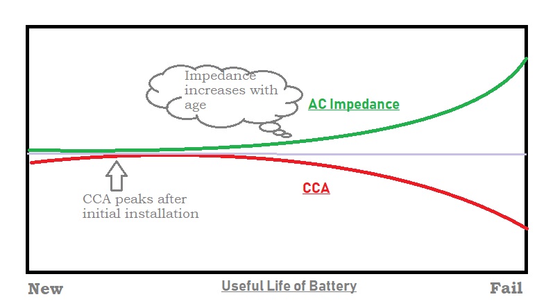

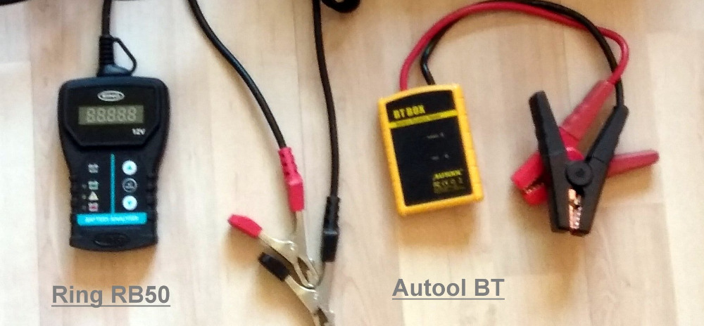

8 years 3 months ago - 8 years 3 months ago #21918 by Andy.MacFadyen
AC Impedance Automotive Battery Testers
These testers are have become very popular over the last 20years, they work by super imposing and AC square wave one the battery voltage to measure the the AC impedance of the battery and using this to estimate the CCA of the battery and remaining life left in the battery.
Impedance is the equivalent of resistance to an AC signal. In theory this type of tester will work on batteries that are below 50% charge.
I have been using this type of tester for about 5 years a RIng RBA50 Link to RBA50 on Ring Automotive UK Website
Using this type of test tool is simple
Step (1) Connect to battery
Step (2) Tester displays battery open circuit voltage, as a guide to state of charge of battery.
Step (3) Tester prompts to select CCA unit of battery ie CCA, EN, DIN....
Step (4) Tester prompts to select CCA value.
Step (5) Presss enter and test starts
Step (6) Tester displays Pass or Fail, % of Battery Life Remaining and Estimated Actual CCA.

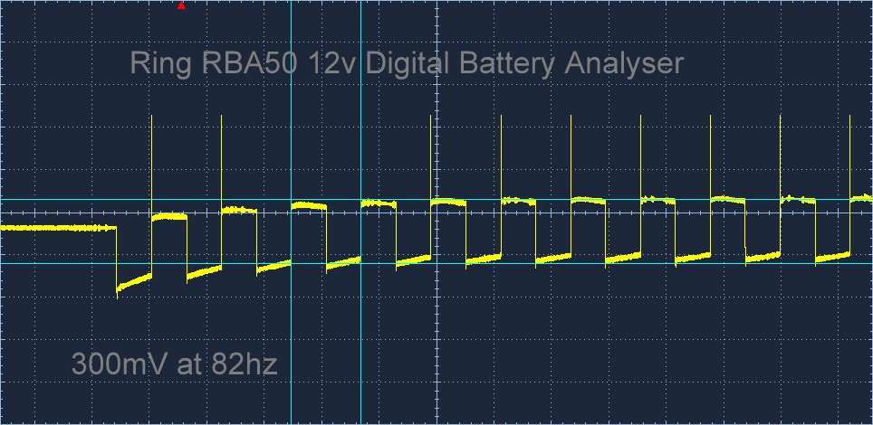

The tool is powered by the batteries own voltage and using an oscilloscope reveals it places a 300mv AC 82hz square wave across the battery terminnals.
