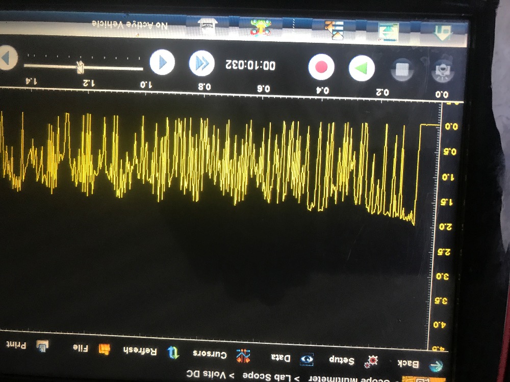

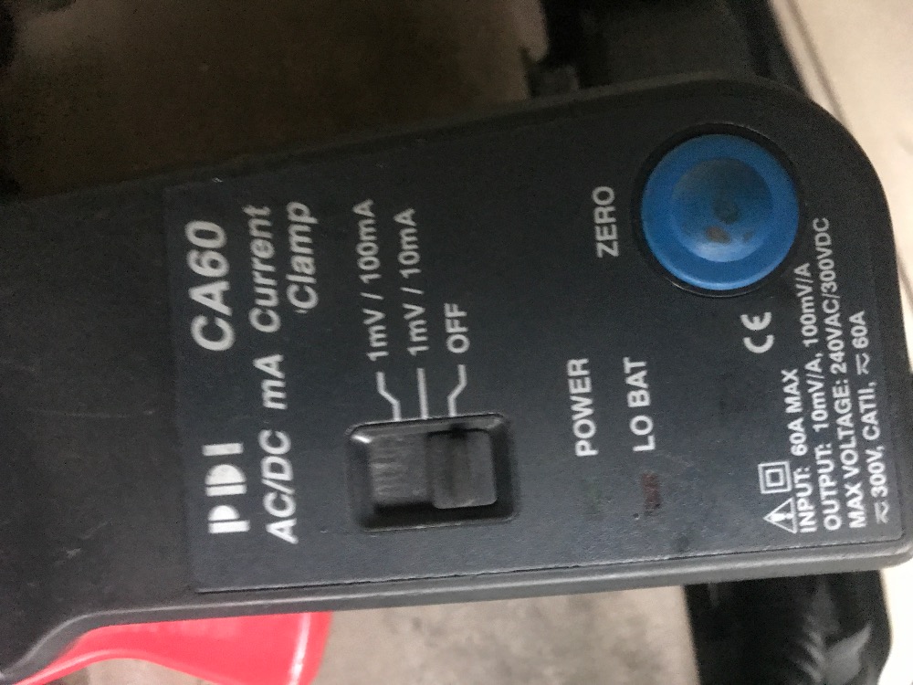

9 years 5 months ago #9799 by Harrison3267
Not sure how to do the conversion.
I'm using an amp clamp to gauge the amp draw on a starter. Can anyone explain both of the settings on my clamp as to what they would be per volt. Pictures below included.

1mV conversion to volts = 1mV x 1000= 1000mV or 1 volt
For the 10mA scale: 10mA x 1000= 10.000mA or 10 A
For the 100mA scale 100mA x1000= 100.000mA or 100A
1mV/10mA = 1V/10A
1mV/100mA= 1V/100A (your clamp has a max input of 60amps)
1 mV/10 mA (100 mV = 1 A)
—> use this for testing currents up to 20 A.
1 mV/100 mA (10 mV = 1 A)
—> use this for testing current up to 60 A.
Make sense?
So you'll need to use a high amp clamp to measure starter current... ;)

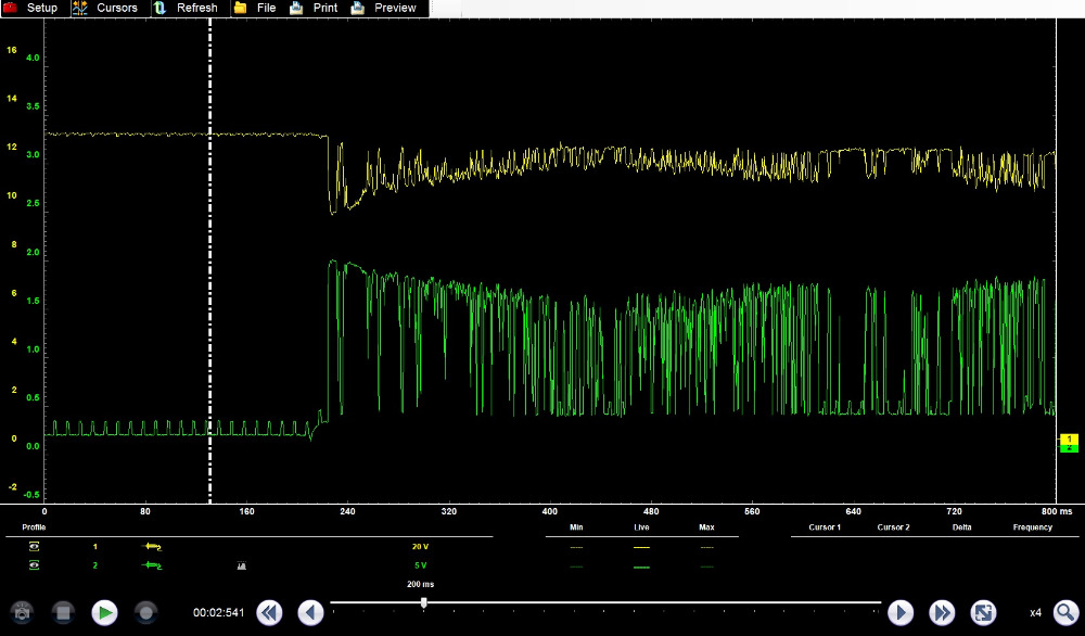

9 years 5 months ago #9818 by Tyler
Dylan has the math right for that clamp. It looks like the peak current seen during the start of your capture is about 2V, with translates to around 200A. The clamp is rated to 60A, but I've found most low amp probes are actually capable of measuring much higher. I use that same style of clamp for relative compression stuff all the time.
For comparison, here's a waveform I took off a 2.4L Honda with a failing starter. Yellow is battery voltage, green is starter current.

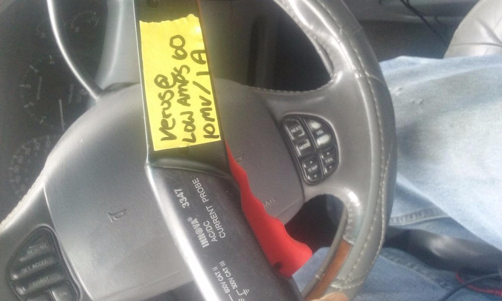

9 years 5 months ago - 9 years 5 months ago #9846 by Noah
I use an Innova 3347.
When set on 10mv/1A, it is accurate on the Verus low amps 60 setting.
I like to write stuff like that right on the tool, my Verus has similar notes on it...
